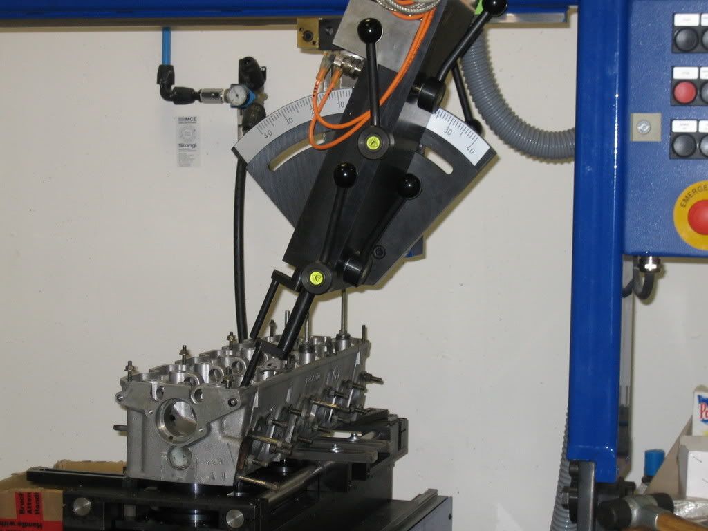

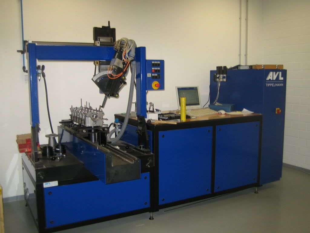

I've used an AVL Tippelman flow bench, which cost in the order of 300,000 Euros and cost 7500 euros to calibrate/validate a few months ago :shock:
The mammoth flow bench measures flow and motion, broken down into the components of swirl and tumble.

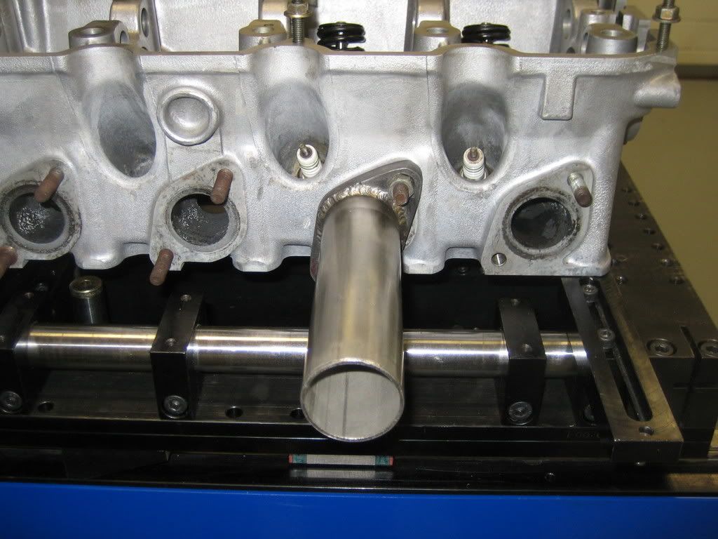

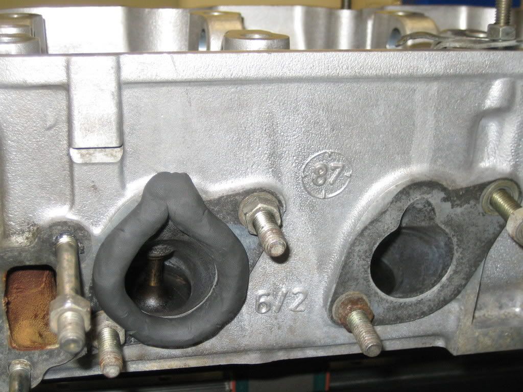

For the intake I moulded a bell mouth to minimise intake losses/invalidating the results
For the Exhaust I made up a diffuser pipe for the same reason

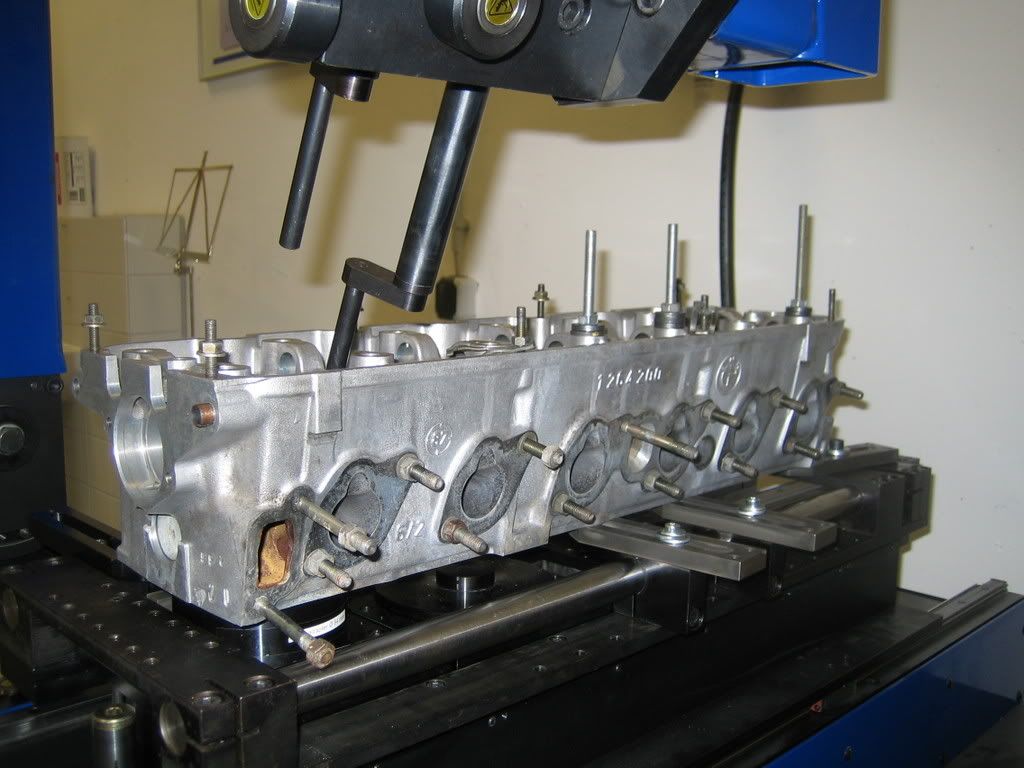

Automated valve opener makes my job easy :wink:

All in all there are 3 variants of the BMW M20 series, which affcionados will be aware of, the 1970s 323i head-casting number 1264200
the 1980s 323i, head casting number 1277731
and the mid to late 1980s 325i casting number 1705885. Each of these I tested and changed the bore sizes significantly to see the sensitivity to 'bore shrouding' [ When involved in the Jaguar and Aston Martin V8 development I found those engines very sensitive to bore size-effecting flow significantly]. The M20 engine isn't sensitive to bore shrouding. This is probably because
