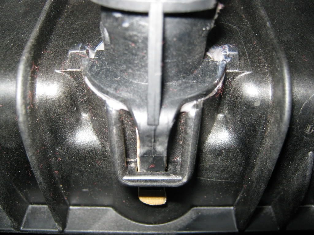

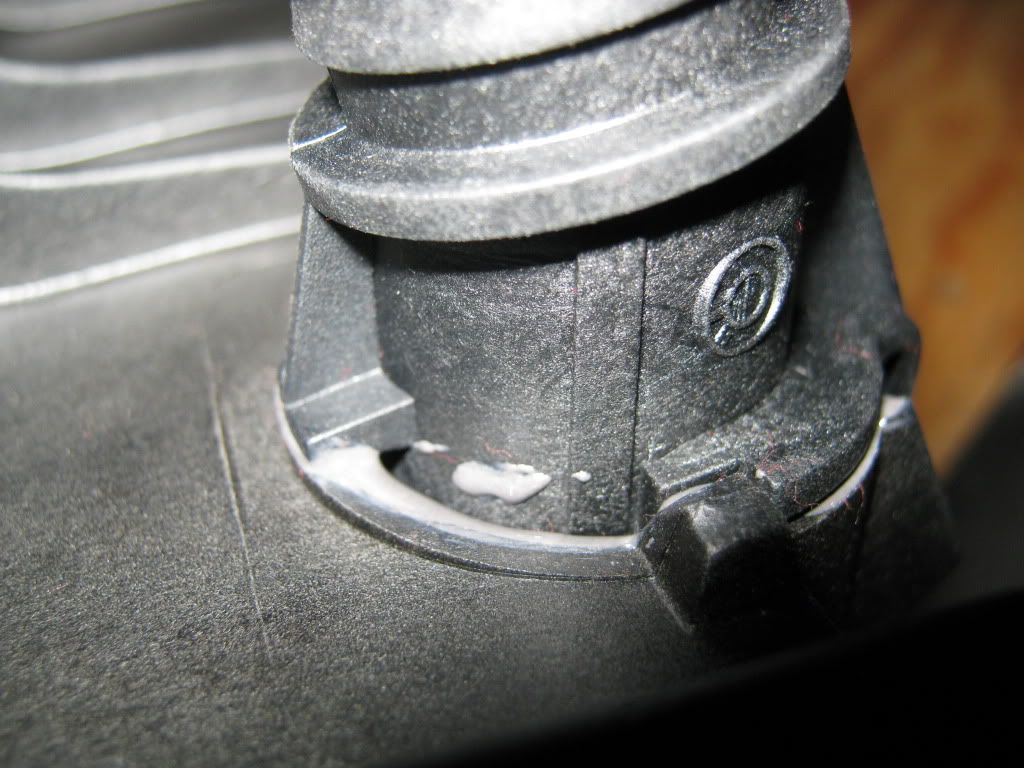

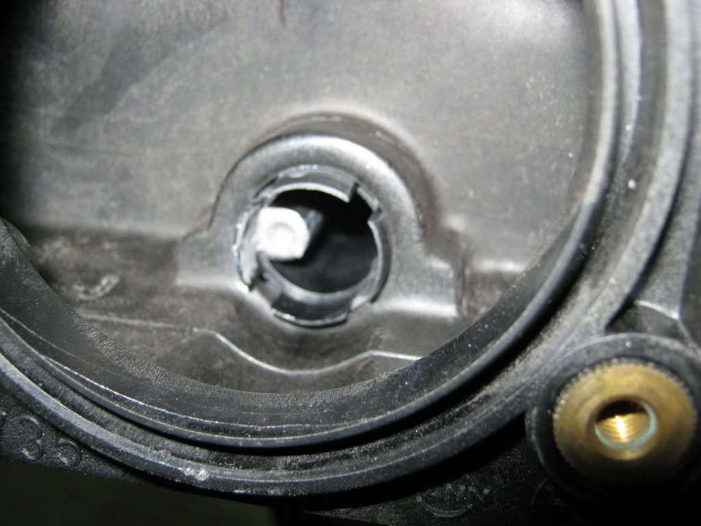

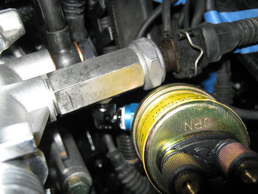

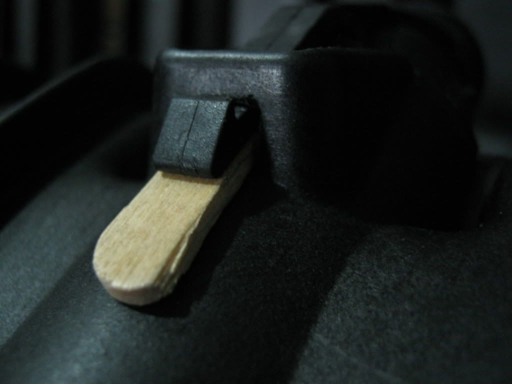

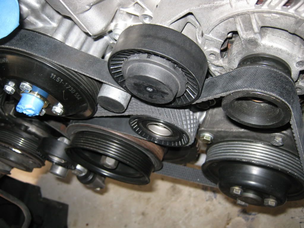

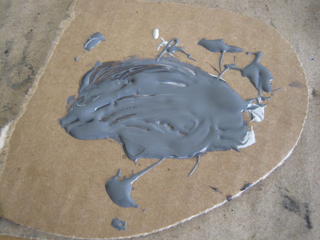

milKt wrote:Interesting slingshot visual/description of how you have held her in place, but boosting to 0 PSI seems risky. :eek:
While I'm waiting for a few welding repairs/additions to the hardware,
I flopped some JB Weld on her and snugged the IAC/ICV adapter into position (I love pictures),
added a homeowner popsicle stick leverage to the clamp (incredibly technical decision here based on temperature resilience, rigidity and taste)
and glopped the glue to the vacuum port on the adapter.
A frow'd the serpentine belt on
and buttoned up the oil pressure sender config
