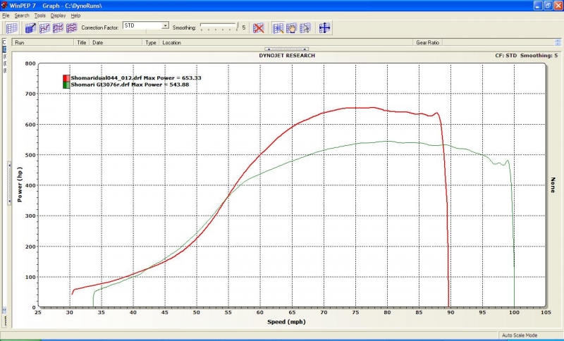

dsm-onster wrote:I have Morphius' permission to post up some impressive results from a user who doesn't have the status to access this forum yet. Badman21. 653whp. 40psi with the HX40 with small BEP housing
Mod list copied straight from his private message:
2.3 stroker motor
eagle rods and weisco pistons 100mm 4g64 crank
hks 272 intake and exhaust cams
stock 2g head
ptt twin disc clutch
dogmisson from magnus motorsports
holset hx40m with .55ar
3inch downpipe into a 4inch exhaust
shearer fabrications t3 exhaust manifold
magnus motorsports intake manifold with q45 thottle body
slowboyracing intercooler
dual bosch 044 fuel pumps -8 fuel feed line
4 1600cc injectors
wolf ems standalone system tuned by waynespeed

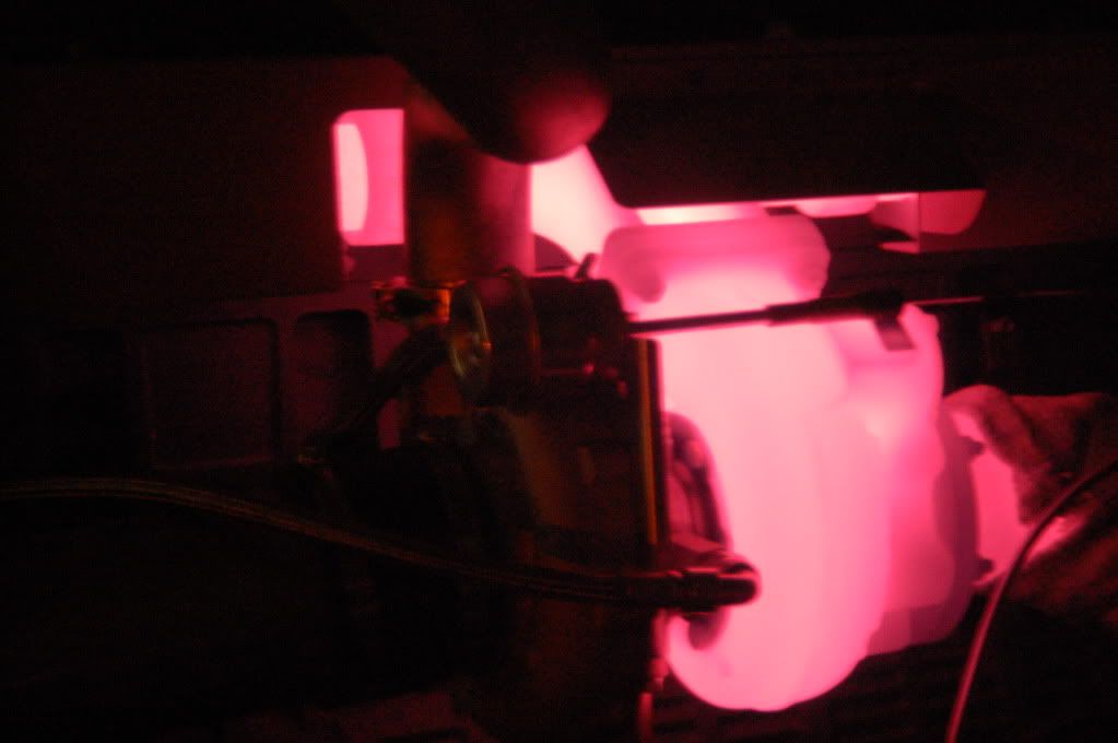

Svo það sé á hreinu að díesel túrbínur þola hita fínt.
Hönnuð til að þola svona átök í 3500stundir.
HX55 að framleiða 300hö @ 2000rpm á 11L díesel vél
